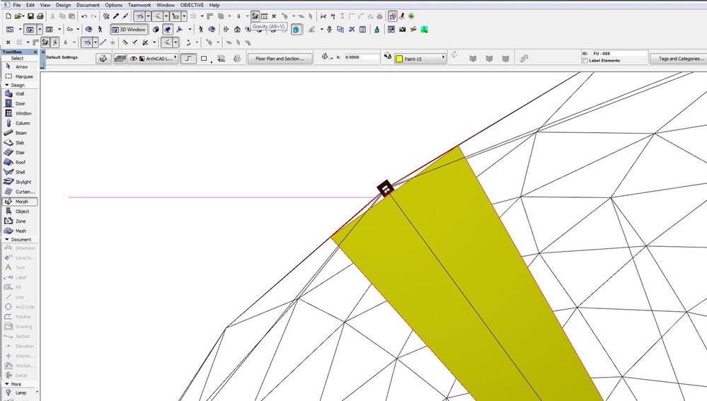

I'M HAVING A REALLY BAD TIME TRYING TO ALIGN THE EDGE OF
A 3D OBJECT TO A CERTAIN POINT OR EDGE IN ARCHICAD 16.
I WANT TO KNOW IF THERE ARE ANY ADD-ONS APART FROM
OBJECTIVE OR CIGRAPH, (BECAUSE I'VE ALREADY TRIED
THOSE AND THEY WEREN'T ANY HELP) , THAT COULD HELP
ME ALIGN 3D OBJECTS USING 3D REFERENCES,
OR A TOOL IN ARCHICAD.
IN THE IMAGE I ATTACHED YOU CAN SEE WHAT I MEAN MORE CLEARLY.
ALL I NEED IS TO ALIGN PERPENDICULARLY THE FACE OF THE TUBE
(PURPLE LINE) TO THE GREEN LINE, OR THE ORIGIN IS THE SAME.
THANKS! AND SORRY FOR MY ENGLISH

OK GUYS I WAS ABLE TO DO IT BUT SACRIFICING
THE OBJECT PROPERTIES FOR A MORPH.
AFTER THAT ALL I HAD TO DO WAS PLAY WITH THE EDITING PLANES, IT
WAS REALLY REALLY ANNOYING BUT I DID THE WORK.
What object are you refering to ?
AC12_27 |Win11_64bit|
HI, THE RECTANGULAR TUBE WAS AN OBJECTIVE NATIVE OBJECT WHICH I COULD MANIPULATE, CHANGE DIMENSIONS, THICKNESS, ETC.
