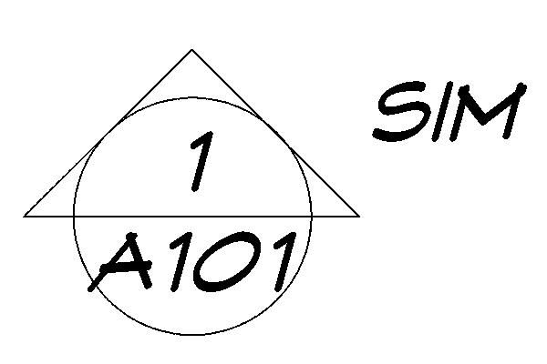

Is there anyone there able to help me get this font ARCHITXT fonts as shown in the pic here for Archicad. I have it in Autocad but it is in SHX format and can't use it for Archicad.
ac7/xp
ac7/xp
Find the similar True Type font, and assign it in the translation font table. If you wsnt to translate SHXs to TTFs, you have to have both of the same name. All the standard SHXs have corresponding TTFs provided by Autodesk, when you install AutoCAD. So the person you got the drawing from might have the TTF?
