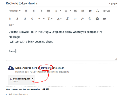

Use the 'Browse' link in the Drag & Drop area below where you compose the message.
I will test with a brick coursing chart.
