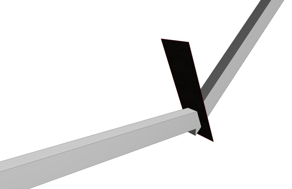

It still won't be right, Jeff.
Roof objects will join correctly, if you don't mind using a roof in place of a beam.
MrC
ROOF SET TO ZERO THICKNESS AND AT THE APPROPRIATE BISECTION ANGLE AS OPERATOR IN SEO'S

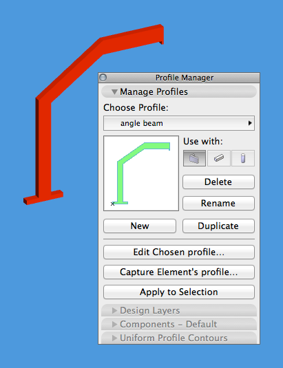

Dwight
You could create the entire assembly using a complex profile and laying it down using a wall ACROSS the span direction.
Dwight Atkinson
There is another relatively simple and fast method.
See the attached image.
SEO is performed
The inclined Beam is the Target, the horizontal Beam is the operator.
Depending on the situation you perform a Subscription with upward/downward extrusion SEO.
MrC
