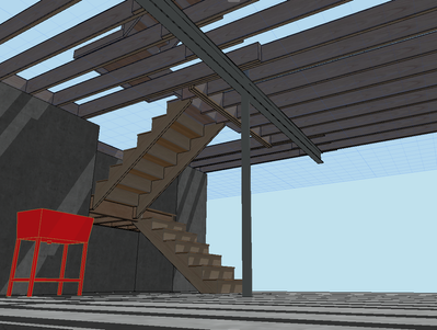

Hey folks,
Another newby stylistic question as I dive deeper into Archicad.  I've completed the aesthetic design of a small residential house as a learning exercise and am moving on to adding details such as floor joists, framing, etc.
I originally used composite exterior and interior walls from a template to quickly visualize my design but am now going in and modeling actual studs / joists to better understand and communicate the framing. Is it typical/best practice to DELETE the original composite wall and rely entirely on the individual beams and columns for the studs and drywall - or do the original composite walls live-on in the model alongside the detailed framing members?
Sorry for the naïve question - I'm still a bit opaque on how Archicad organizes information. The whole concept of layers is still a learning experience for me!

I personally wouldn’t delete my composite walls. Are you using the wall framing object to create your wall framing ? If so, you need to keep your composite wall and just draw your framing right inside your stud wall framing part of the composite wall. There is more than one way to create timber framing as you may or may not be aware of ? Displaying your framing model in 3D would require a specific layer set to be created and turned on. You can however turn off of your composite wall layers if they interfere with what you are trying to display. Others may have a different method to me on how to display 3D framing in Archicad.

Thanks for this response and thanks for the links!! - I did initially use the framing function and it's results were pretty solid - but not exactly what I was hoping for in a few key areas. There didn't seem to be much ability to alter them - it seemed like an all-or-nothing sort of function.  Maybe that's wrong. I've been looking for input on what to model in 3D and it feels like there's a pretty large group of people that try to model all the framing out.  Maybe that's not true?

Any insights like this are really helpful. I'm working through framing in a u-shaped staircase and getting the tool to do what I want it to do has been excruciating.  And my drawings are a mess so the whole layers/pens/graphics is still a bridge too far for me. I'll get there!   I'm honestly not sure how much of this is typically detailed out and how much is left to the contractor to sort-out on site so any continued guidance will really be valued!

With stairs, I will usually set the rise and run with the tread width and get it to meet the floor above and ensure it complies with the building code requirements. With the fine detailing, I will usually leave that to the specialist stair fabricator to do along with the railing that needs to comply and how it is all anchored down and secured.
