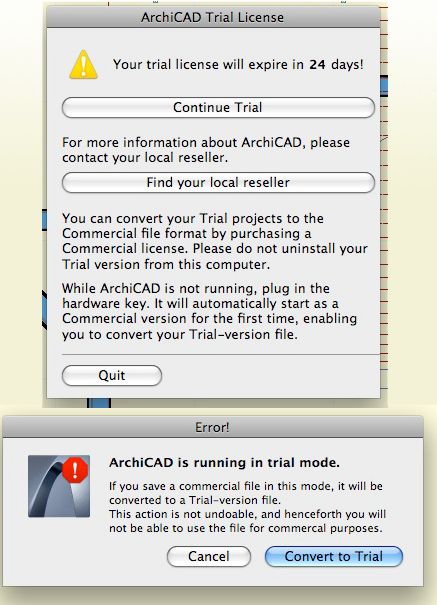

Can someone explain which of these two dialogs is correct?
Can a trial document be converted to commercial?

The Urban Legend is that you can convert a Trial Project into a Commercial by buying a new key that will be able to unlock the Trial limitation. Opening a Trial Project with another AC license is not possible AFAIK.
I think that it works like a 30 day education license.
