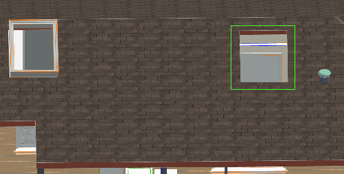

This pln file was migrated from older computer, but still from AC-12, with the same 2 libraries, (AC-12 and my standard office library).
It's Skylight Flat Panel-12 right from AC-12 lib.
Whether moving or deleting the skylight, the opening remained no matter if I deleted it while in 3d or 2d.
The opening would not go away on it's own until I took the remaining hot spots from the edges of the opening and combined them.
However, if I place this same skylight in the same roof and then delete it, the opening heals correctly.
Obviously not a big deal but curious, is this a known bug?

It may be a bug, but it also possible that the skylight was placed as an object and the roof hole manually created. A simple misuse perhaps?

Thanks for the reply.
Forgot to mention that no seo's involved and to verify I had checked my seo layer's to see if either one of them had something on them.
None regarding roof.
Also don't remember having any trouble with the object cutting the openings in the first place, as in fact it does not now.
Maybe somehow the object lost it's remove opening "handle".
But if that's the case, guess it would be hard to prove as "bug".
I remember that there was an option when opening older projects. It asked whether you want to convert Skylights for the new project.
Maybe they were not chosen to be converted, hence the separate and independent hole.
Don't remember an option to "convert Skylight" but just because I don't remember that option sure is not prof it was not flashed on screen and I ignored it.
