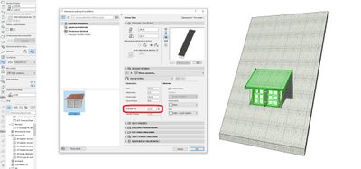

I've got a problem with the native Dormer Shed in Archicad 25 and 28. I think its maximum Shed Roof Pitch value (screenshot) is hardcoded at 35 degrees. This is highly impractical and illogical limitation, and it should be increased to something like 89 deg. Sadly, I can't edit GDL myself, so I'm hoping someone would be able and so kind to try fixing it.
I placed it as skylight but the issue is the same if placed as an object.

Yes, the limitation is a safeguard, but it can be removed... here is the link to the edited object.
You just need to modify the ranges from the parameter script and the hardcoded reset for the shed angle in the master script.

BrunoH
Hi Mike96,
You are wrong, as the limit is a calculated one. It is calculated as Roof Angle° - 5°
No need to edit the object.
This object shall be place on a Roof and need the Roof Angle to calculate some of its parameters.
And after that the Roof Angle may be changed and the object shall recalculate its parameters and insure coherent ones.
When you open the tool options, the object is'nt already place in a roof and it can't read the Roof Angle so the limit is calculated with the default value set in it. The default value is set to 40° that's why at first the limit is 35°.
So if you place the object on a roof with the Roof Window tool, place it first on the roof, select the placed object and open its options, the 35° limit should have been changed.
If you place the object with the Object Tool, there's no Roof Angle to read, so you'll have to set it first yourself, in the All parameters dialog off the object (see images).

Mike96
BrunoH,
what you're saying makes sense to me, but it's not true. At least, it's not what I'm experiencing in my Archicad. I placed a dormer in a steep roof, say, 60 degrees pitch, and tried adjusting dormer pitch afterwards. It was still stuck at 35 degrees.
You're talking about theory, how this SHOULD work, but have you actually tested it yourself? Haven't you been able to replicate my issue?
There must be some bug in the original version, since it doesn't work the way you explained.
Anyway, the problem is solved now, thanks to Jaime-airc_digital.
