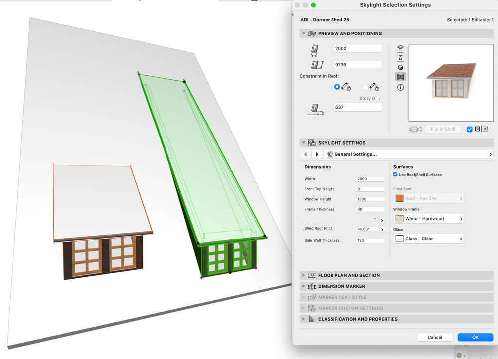

I've got a problem with the native Dormer Shed in Archicad 25 and 28. I think its maximum Shed Roof Pitch value (screenshot) is hardcoded at 35 degrees. This is highly impractical and illogical limitation, and it should be increased to something like 89 deg. Sadly, I can't edit GDL myself, so I'm hoping someone would be able and so kind to try fixing it.
I placed it as skylight but the issue is the same if placed as an object.

Well, they certainly are not perfect for 2D documentation but sufficient for 3D presentation and that's what I need right now (and pretty often, too). I work with heritage architecture on a daily basis, producing both 2D docs and 3D models, and not gonna lie, these objects speed up roof modeling significantly, until... You need steeper roof.
Why even keep such libraries in database when they have such weird limits imposed? It's not like a feature missing, it's not underdeveloped. I don't know what the author had in mind: "hmmm, no one would surely use a dormer roof above 35 degrees, so let's make it a limit!" ?

Yes, the limitation is a safeguard, but it can be removed... here is the link to the edited object.
You just need to modify the ranges from the parameter script and the hardcoded reset for the shed angle in the master script.
