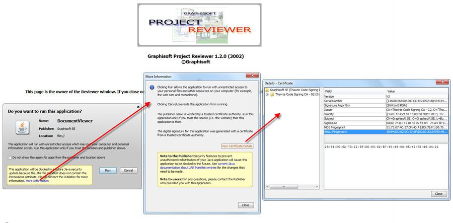

Link wrote:
Got so close this time, but still no cigar! What gives? Same deal in Chrome, where it is supposed to work according to tech support.
Link, we will check what we can to to make Reviewer work, but I have a bad feeling that the browser security improvements are always ahead us. Which is good in general, but not for our Reviewer. This browser based Java technology was a great way to create platform independent content, but the fact that it was a source of many security risks resulted strict steps agains this technology.
The majority of the browsers block local Java based content, also would require you to lower the security settings in the browser, which we cannot really recommend.
We are checking here the possibilities, what better alternatives we can provide.

Link
Graphisoft Partner
Graphisoft Partner
Hi Marton
Thanks for your reply, it's great to know you're actively listening.
You know, having looked at it in a little more detail, it does looks like the writing may be on the wall for the Project Reviewer. The second dialog link takes you to http://docs.oracle.com/javase/tutorial/deployment/jar/secman.html and it concurs that the security settings may be making this all too hard.
I suspect this may be an opportune time for BIMx to step up.
Looking forward to the future! Thanks again.
Cheers,
Link.
