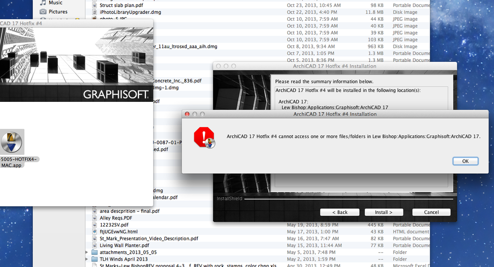

Having difficulty in understanding what is needed to correct the error of a file that is not accessible.
Unexplained permissions error it seems, Lew. First try Disk Utility and Repair Permissions, then try the hotfix again. If that doesn't do it, the easiest (brute force) method of fixing the permissions is go to Applications > Graphisoft and right-click the ArchiCAD 17 folder and select Duplicate. Then rename the original ArchiCAD 17 folder to ArchiCAD 17-old, rename the new folder to be just ArchiCAD 17 and repeat the hotfix installation. (Creating a duplicate should force all items to have your default permissions.) Delete the '-old' folder if successful.
