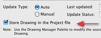

I'm surprised that text/schedules might be the cause of such file bloat, but who knows?! Out of curiousity, for your placed drawings settings, do you have the checkbox "Store Drawing in the Project File" checked? You might try unchecking that for all drawings. (Not sure, but imagine you need to be TL with exclusive access to change this?)
