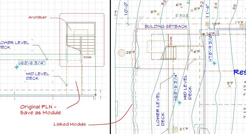

Previously, when I had added a saved Library object that contained an ArchiStair created stair, the saved library object displayed just like the original when placed in other PLNs.
Now the Display of the Stair (Landing, stair break and Arrow) are displaying differently in the placed library object than in the original file in which the object was created.
Has anyone else seen this. Like I said, this use to work correctly.
1 Reply 1
Work around seems to be to "completely" display the ArchiStair Prior to creating the Library object. This is can be done in the last tab page "2D Symbol Settings". See attached. After the Object is created the Stair display options can of course be switched back.
