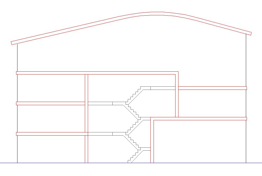

Hey,
Anyone know the best way to create a roof with the section shown in the attachment as its got a curve at the apex rather than normal pitched roof with a point.
I've just modelled it by creating an object so far but of course you cant use trim to roof command or anything like that with the object and now that its past being a sketch it would be handy to have it modelled properly.
Thanks.
1 Reply 1
This is really simple. create the profile of the top of the roof on plan. Now create the roof using Barrel Vaulted ceiling, by pressing Space on your profile. Follow the instructions from the Status Bar. That's it.
PS. Segmentation is controlled by Magic Wand Settings.
