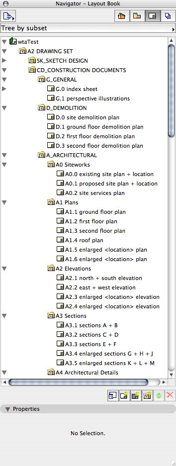

__archiben
here's some feedback:
don't try opening an AC10 intel-saved file (10.000 m /943) with the PPC version of AC10 if you value your entire layout book structure and master settings.
thanks a bunch mr graphisoft.
~/archiben

__archiben
owen wrote:
I assume its reproducible all the time? What about the view sets? Just wondering as it sounds similar to All views and layout subsets vanish upon opening project
Fortunately this doesn't seem to be an easliy reproduced bug .. for me at least.
it's a template file i've been spending (a lot of) time on recently. i haven't defined the views yet - just the standard layout hierarchy - it has over 100 layouts in it. maybe there's a 'i-can't-handle-anymore' cut off?
i've tried saving and saving as..., opening on my own computer running AC10PPC in rosetta and on the rest of the office machines running AC10PPC natively.
i think this is a very similar bug to james', but luckily nowhere near as nasty in the severity stakes . . . more so because it's not a file that's in 'production' than anything else . . .

maybe someone could try my file? i've stripped it out of all information except for master settings and the layout/sheet organisation structure. it's been re-saved and tested again here with the same result: if you open it with the intel (10.0.0 RC1 INT (943)) build the layout structure and master settings are retained, if you open it with any PPC (10.0.0 v1 INT (817)) build everything is lost . . .
it's too big to attach here (571Kb) so anyone willing to give it a whirl may find it in my dotmac public folder (Finder: Go>iDisk>Other User's Public Folder... member name: "archiben", password: "archicad") . . . below is what the layout book hierarchy should begin to look like.
i'd appreciate anyone being able to either confirm whether or not it happens in their setup. i can at least then start looking for the problem in the right places . . . cheers!
