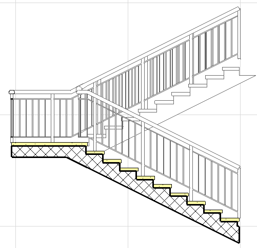

Here is another little new feature I see no mention of:
In StairMaker, it is now possible to define the Section Fill Type, Fill Color and Fill Background Color for both the Structure and the Treads.
This is useful stuff for me.
Here are the settings in the Treads Tab page.
Of course these parameter are also available among the parameters in the Stair Settings Dialog.
What I found is that if you create a new Stair in AC14 these new parameters will be available immediately.
However, if you open an AC13 Project in AC14, you will have to select each different Stair type and go to StairMaker so that it reads these new parameters. Then you will have them available for your Stairs in those Projects too.
And the result.
