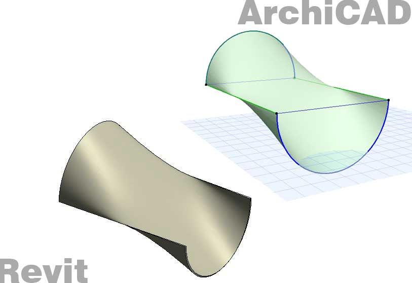

Thanks you guys for the reply. I have another question. I have seen that you`v made some improvements to the IFC compatibility. Maybe i dont know exactly how IFC works, but in AC 14 i tried to import some non-standard organic shape made in REVIT and it only recognized the horizontal geometry as slabs the vertical pillars and the usuall horizontal beams.
Will the new Shell Tool make AC 15 recognize all type of shapes and import them with the IFC standard?
NCornia
Graphisoft Alumni
Graphisoft Alumni
Coty82,
The shell tool will not help ArchiCAD recognize IFC shapes better. The problem most likely lies in Revit's IFC output. You can verify this by downloading Solibri model viewer (Free at www.solibri.com) and import the IFC file there. If the geometry does not appear correctly in the model viewer then either the program that authored the file does not create proper IFC output or the user did not perform the output correctly. For more on this refer to this link: http://archicad-talk.graphisoft.com/viewtopic.php?t=36330
ArchiCAD is the leader IFC and open file formats in the architectural BIM world and Autodesk has shown some commitment to the IFC standard but from a business standpoint I do not believe they are moving forward with it as fast as the rest of us would like. You will notice that as part of AC 15 is that IFC properties are now native to the objects, making it even easier to classify elements properly along with many other improvements seen here: http://www.graphisoft.com/products/archicad/open.html
The only way for IFC to become a universal standard is if there is pressure to have such standards and for software vendors to be willing to cooperate and improve their IFC interchange.
Nicholas Cornia
