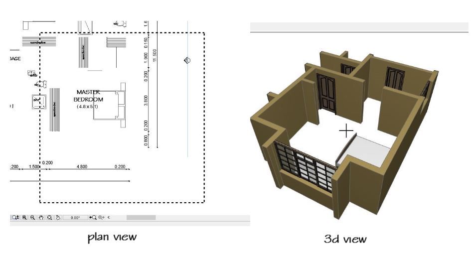

walls(including doors,windows and openings) do not appear on plan but appears in 3D window,,,please help[/img]

Check which renovation filter you have active in the plan view.
If that is not it maybe the walls are on another storey.
Or maybe you wall display is set to "Cut Only" and your Floor Plan Cutting Plane is set above the walls.
Or it could possibly be that the layer is turned off in the plan view but is turned on in the 3D view.
Another possibility is the Partial Structure Display set for the plan view - but then I would not expect to see the dimensions either.
