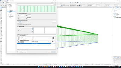

Hi, I am trying to create a simple steel bar railing to a wall head, I watched a few YT videos and I noticed the US library has a simple steel railing option, UK only has 3 and none are steel options, I tried playing around with settings but couldn't get bar balustrades to appear. Any help greatly appreciated.

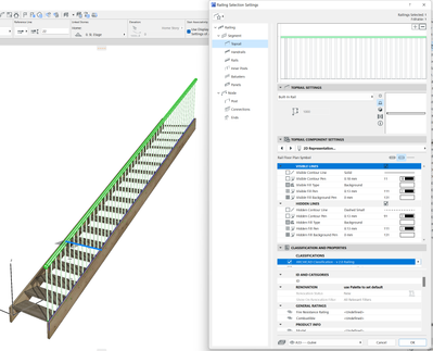

Not sure whether this is exactly what you are looking for, but just made a brief Railing where segment consist of Balustrades+Toprail, then there isa Post added to the node (Like nodes/corners on he construction line of the Rail) Alle Materials should be Generic Structural, so you can change them to Wood or steel...
I´v added the rail as a Favorite (xml) sp you should be able to import it via the Favorites palette:

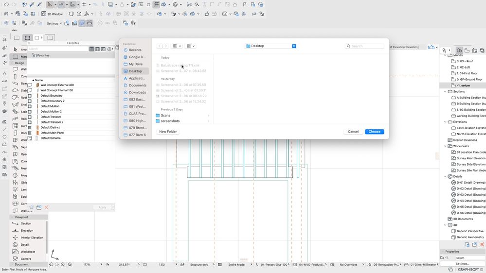

When I try to import file to favourites it is greyed out and cannot be selected 😅
see screengrab

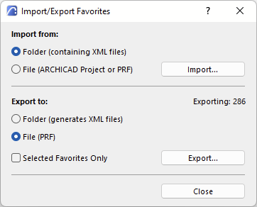

Thomas Nymann
Did you choose .xml (In a folder?) as the format to import ?

Im running A25 SOLO licence might have something to do with sharing maybe
Hi Thomas, I figured out the railings just there, I didn't realise the + and - you could add and delete elements of railings, I got it now, thanks for your help!
Running AC Start Edition, could be a challenge, but I don´t think "solo" should be a problem. However Practice makes King 😉 So maybe just try on your own, and make sure to add Balustrades in the settings chapter: "Segment"
of you Railing 😉
