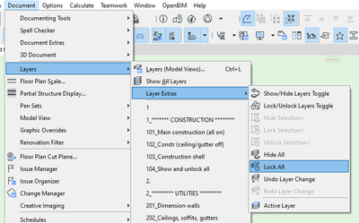

How do I select all layers, lock/unlock and hide/show all layers in the new layers window?
AC26 AUS Full
26 Replies 26
@Daniel Pataki wrote:
If you only want to see temporarily all layers, there is anyway a better method:
Menu/Documentation/Layers/"Show all layers" - I can strongly recommend to make an icon for it, so it will be a way faster way to see everything alltogether.
I forgot about that command.
I even have it as a tool in my tool bars!

Quick layers is a really helpful tool once you figure out how to incorporate it in your workflow it will save you the hassle of opening up your layer dialogue box.
For example you want to isolate layer like what you have mentioned, where you select all layer then you select two or three layers in quick layers you simply select the elements you want then simply press press the button "hide others' layer"
and once you have finished doing what you need to do you can simply click this button to undo the layer control change you did.
I hope this helps you in your workflow. 😎

I just re-discovered that as well as the 'Quick Layers' palette, you have all of the commands in your menus.
I never use them so forgot they were there.

kevin b
This is exactly right! All of those saying use Quick Layers it doesn't do this, all off/unlock and then turn on/unlock the 2 or 3 you need. I do this all day long. I also use quick layers all day long for what it does, but it is not the same.
