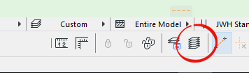

@Daniel Pataki wrote:
If you only want to see temporarily all layers, there is anyway a better method:
Menu/Documentation/Layers/"Show all layers" - I can strongly recommend to make an icon for it, so it will be a way faster way to see everything alltogether.
I forgot about that command.
I even have it as a tool in my tool bars!
The problem is that when you create new layers then you have to keep editing this combo and the removed buttons made it easier. As mentioned during the Beta, this was an extremely dumb decision by the designer in charge since there was no need to remove them except that the designer apparently doesn't know how to use AC.

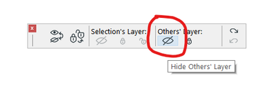

Quick layers is a really helpful tool once you figure out how to incorporate it in your workflow it will save you the hassle of opening up your layer dialogue box.
For example you want to isolate layer like what you have mentioned, where you select all layer then you select two or three layers in quick layers you simply select the elements you want then simply press press the button "hide others' layer"
and once you have finished doing what you need to do you can simply click this button to undo the layer control change you did.
I hope this helps you in your workflow. šŸ˜Ž
