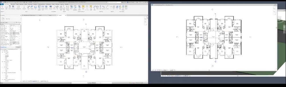

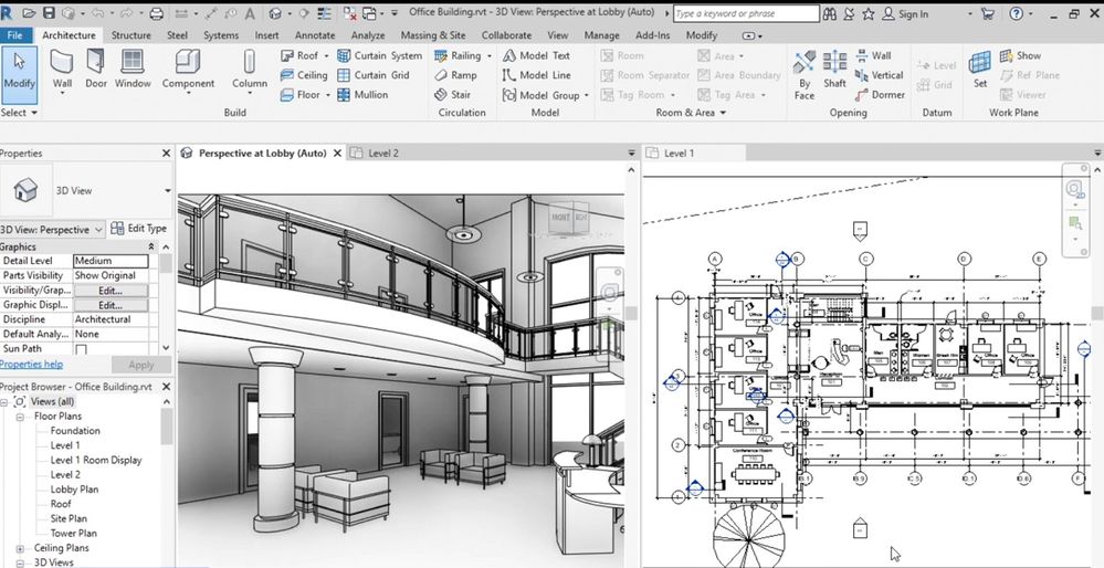

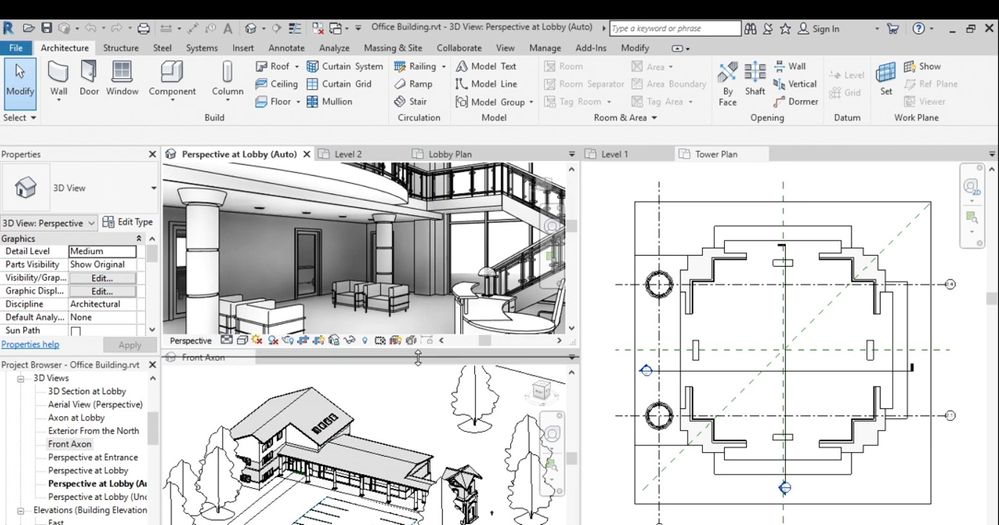

I haven't got the chance to try the new AC26 yet (still on 25), but I was wondering if someone knows if they actually listened to a large group of people who wanted/needed the possibility of moving the view tabs to another screen or split the main screen in 2-3-4 windows?
I mean, is that to much to ask? I know Revit has this options since 2019 already. I have attached some screenshots to see what I'm talking about. It would make the workflow so much easier, especially with large projects where you have to pay attention to multiple things when designing.

Screenshot 2022-08-07 173350.jpgScreenshot 2022-08-07 173451.jpgScreenshot 2022-08-07 173426.jpg
