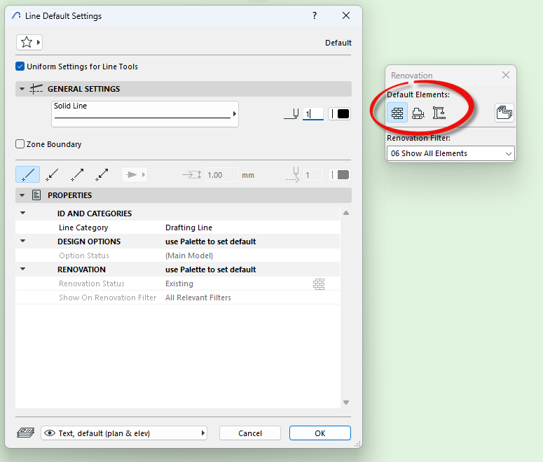

I am getting a ' renovation status is hidden' message when I attempt to use the renovation existing filter. The only way I can draw a line for instance is to draw it in the renovation proposed filter and change its status back to existing. I am sure this is an easy fix but I cannot find it.

The problem I am experiencing is shown on  the attached screenshot which shows  I cannot set the renovation status to existing  when the existing filter is active. In other words lines, walls etc cannot be set with an existing renovation status without changing it retrospectively.
The renovation filter for all tool default settings will be greyed out.
If you turn on the renovation palette, you can set the status to what ever you want and it will affect all new elements you place.
