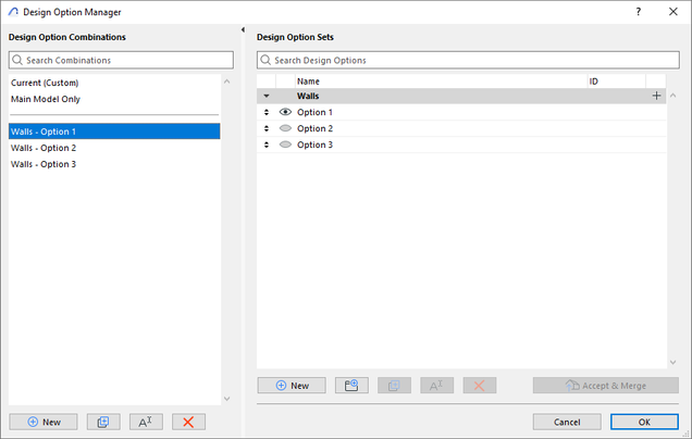

I tried the following: I created a Design Option Set called "Walls", with 3 Design Options in it.
Then I created 3 Design Options Combinations, one for displaying each Design Option.
Then, in the Hotlinked Module source file, I made sure that I have the exact same Design Option Set, Design Options, and Design Option Combination.

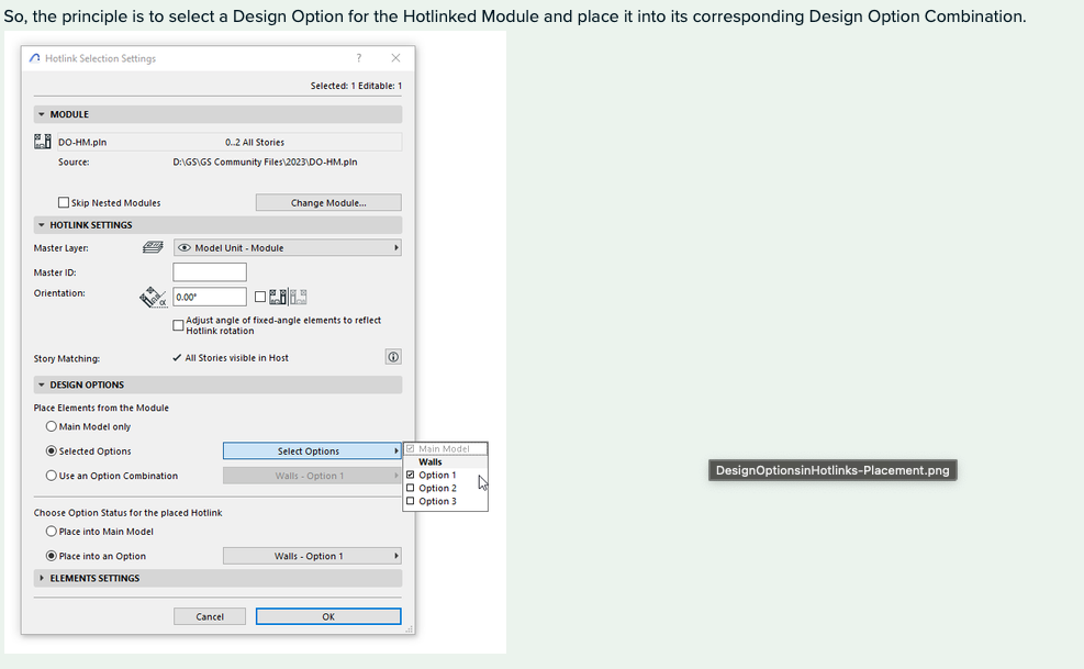

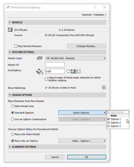

Then, when I placed the Hotlinked Module for Option 1, here are the settings I chose in the Hotlinked Module Dialog.
Notice that in the Place Elements from the Module field, I chose "Selected Options" and chose "Option 1".
Also, in the Choose Option Status for the placed Hotlink field, I chose "Place into an Option", and I chose "Walls - Option 1".
This way, I brought in Option 1 with the Hotlinked Module and assigned it to Design Option Combination "Walls - Option 1".
With this, when I select the Design Option Combination "Walls - Option 1" Design Option Combination, elements belonging to Design Option "Option 1" will be displayed, both in the host file and the Hotlinked Module.
So, the principle is to select a Design Option for the Hotlinked Module and place it into its corresponding Design Option Combination.

Hi Laszlo,
thank you for your in depth answer. I am currently trying to replicate your steps, BUT I am running into the issue that the "Choose Option Status for the placed Hotlink" is greyed out... Any ideas, tips on why that is?
I set up both files (.mod & .pln) exaclty the same. They both have the same design option etc.

Joachim-Daetz
Hey, I did find a solution myself actually - I first placed it on the "incorrect" option. After hotlinking it - I clicked on the "grouped hotlink" and through CRTL+T changed the settings accordingly (as nothing was greyed out anymore). Its a work around that is acceptable 🙂
