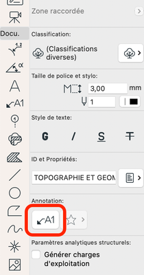

Do you have automatic labels activated in the zone tool settings? If you do, and the label tool is set to a layer that is locked or hidden, you will receive that message.
