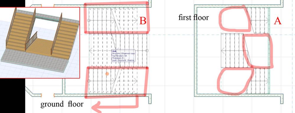

HI all
my first project by AC 17 ... really live in the details .. until I reach to stairs -no any details ..
I need to make this stair with 3 parts .. I made it with 3 stairs and i have this problem
A - in first floor I need to see this part -in attachment -
B - in ground floor this part is unseen ..
I try to change symbol and I have another problem ...any way to solve it
I hope ac 18 is _ stair version _
thank

Eduardo Rolon
Items to check in the Stair Settings:
1. make sure that Floor Plan Display is set to "Home Story and One Story Above"
2. Turn Story Sensitive On
3. Edit 2D Above Home Story Settings
4. Save as Favorite.

Eduardo Rolon
On landing floor plan.
Eduardo Rolón AIA NCARB
AC29 US/INT -> AC08
Eduardo Rolon
One story above
AC29 US/INT -> AC08
Eduardo Rolon
3D Result
AC29 US/INT -> AC08
Eduardo Rolon
Lower Level floor plan.
Run lines are regular lines not the ones from the Stair Object
AC29 US/INT -> AC08
Eduardo Rolon
Level Above
AC29 US/INT -> AC08
Eduardo Rolon
Settings for the Stair from ground to landing
AC29 US/INT -> AC08
Eduardo Rolon
Settings from landing to Second Level
AC29 US/INT -> AC08
thank you ....ejrolon
