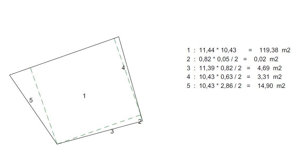

I've been told that untill AC16, you had the option to get an automatic analytical calculation of areas in fills/zones, something like the attached image (which I did manually as an example) I did some research but I didn't a tool that does that in AC17 or 18.Basicaly I want the program to dissect any given shape (fill/zone) into basic geometric shapes and then calculate visibly each area.

But if you want ArchiCAD to define triangles and write down the equation i think you have to code a specific object in GDL.

This was an add-0n developed and released as part of the German Goodies and it dated back to the original appearance of Zones. It seems to have disappeared. I went back as far as ArchiCAD 12 and it's gone.
This was a useful tool. I used it to prepare area certificates for tenant leases. It showed the calculations graphically to demonstrate the veracity of the calculations.

I'm halfway there! The zone area list (I'm using a localized version of archicad so I am not sure the exact term) can do this.Now I need to figure out how to create a list that includes this.
