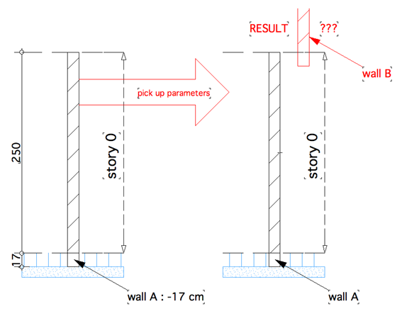

    If you use the eyedropper/alt-click to load up the parameters of a wall the height of the wall is correctly set, but its bottom reference level / absolute base height is as follows:
    the element absolute base height + the height of the current story above the original element's story

The eyedropper/alt-click is a bit of a problem. And the polygonal wall is a bug.
Exactly what I meant when posting a few days ago... The thing with the eyedropper is a real problem because it's against the basics of ArchiCAD : use the eyedropper to continue working with the same element / preferences / etc...
