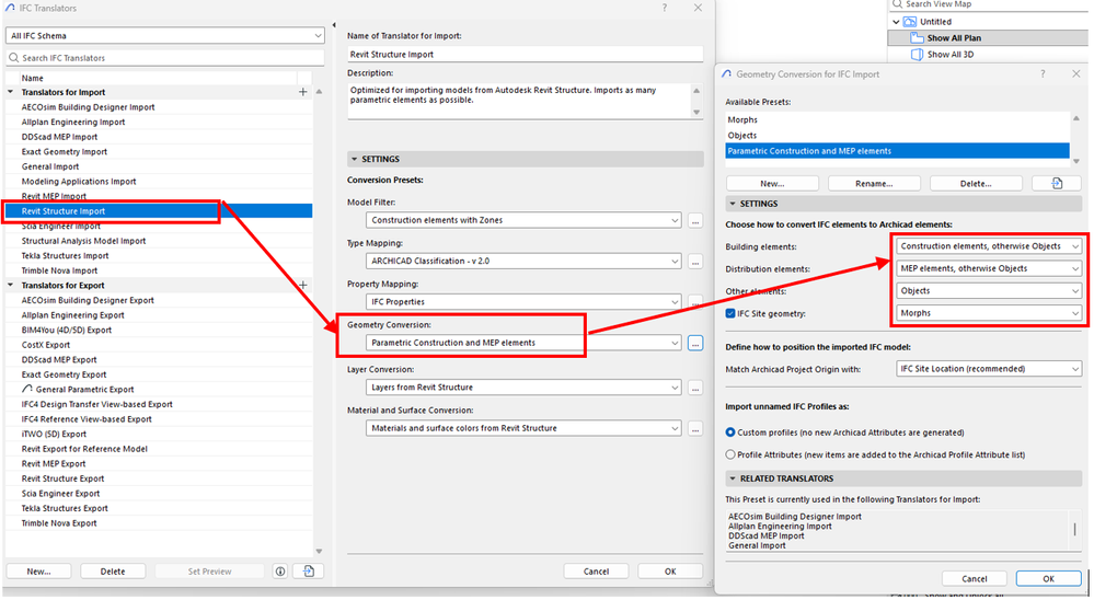

If I was trouble shooting this I would look at this:
why is the structure an Object?
are all the Revit IFC elements Objects?
Objects don't work well with the "floor plan cut plane".
I would check the IFC conversion settings to see if things are set to Objects, or Element or Morphs.
File -> Interoperability -> IFC -> IFC Translators
Revit Structure Import -> Geometry Conversion -> are they set to Objects, Building Elements, or Morphs?
[FIRE BAD, NAPSTAR BAD, OBJECTS BAD, Building Elements GOOD]

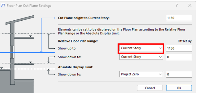

I would also switch the Cut Plane form "Story(s) Above" to "Current story"

Thanks. Most of the walls behave as walls on import, but there are some that get converted to objects. That seems to be a seperate issue, possibly related to how the openings are modelled in revit. Anyway, all objects are shown with outlines only without any indication of where their openings are placed.
The issue here are those elements that do get imported as walls with openings. We have no control over the Floor Display of a hotlinked IFC, and they don't respond to the cut plane settings of the project. (As explained in my first post).
 However, that seems to have resolved itself on it's own, as the latest version of the file the offending walls are suddenly shown as projected. The settings seem to be the same though. ¯\_(ツ)_/¯

Not exactly your case, but I'm importing ProvisionForVoids here as Morphs, and I've to configure the Morph tool first (show on relevant stories...) to get what I want.
It might help to check/set the relevant tools before importing.
