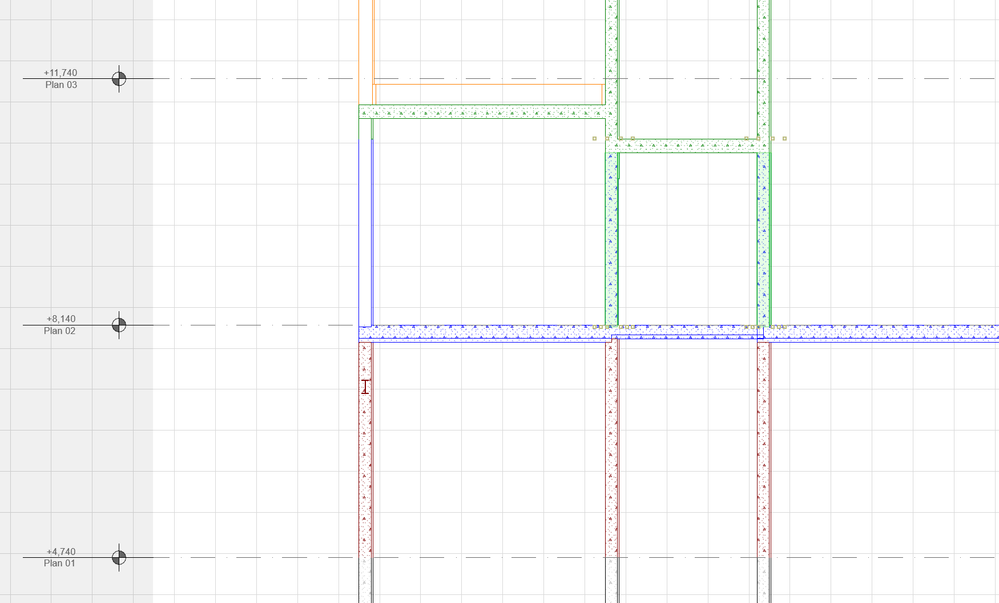

Is there any way to control visibility of hotlinked elements on a per story basis? We have a renovation project where we want to coordinate with the construction engineer and show the concrete walls (from the engineers) in our plans. They are modelled correctly and associated with the right story, but because they start 30 mm below the second story level, they get displayed as if they were symbolically cut on the first floor. The result is that on our first floor plans, both the walls on the second story and the first are displayed on top of each other.
If we change our story definition such that the second story starts 30mm lower, they disappear from the lower story. However, that is not acceptable, as the stories are locked and placed at the level of the finished floor of the new part.
No amount of tweaking the floor cut plane affects this. This seems like a basic functionality that is missing - I want hotlinked elements to be projected just like native elements, and I want them to be represented in the model as they are going to be built.
Story 01: red is story 1 elements, blue is story 2. The blue elements are shown as they would be if they where symbolically cut on story 2.
Story 2: green is story 3 elements. The red story 01 elements stretch over several floors, that is acceptable.
Section: The offending walls from story 2 are shown selected.

And here you see the result of moving story 2 30mm lower. Walls get displayed correctly on story 1 but not a cut of the floorslab is shown on story 2. 😕
Story 1:
Story 2:

Thanks. Most of the walls behave as walls on import, but there are some that get converted to objects. That seems to be a seperate issue, possibly related to how the openings are modelled in revit. Anyway, all objects are shown with outlines only without any indication of where their openings are placed.
The issue here are those elements that do get imported as walls with openings. We have no control over the Floor Display of a hotlinked IFC, and they don't respond to the cut plane settings of the project. (As explained in my first post).
However, that seems to have resolved itself on it's own, as the latest version of the file the offending walls are suddenly shown as projected. The settings seem to be the same though. ¯\_(ツ)_/¯
Previous version:
Current version, same element, same settings?
