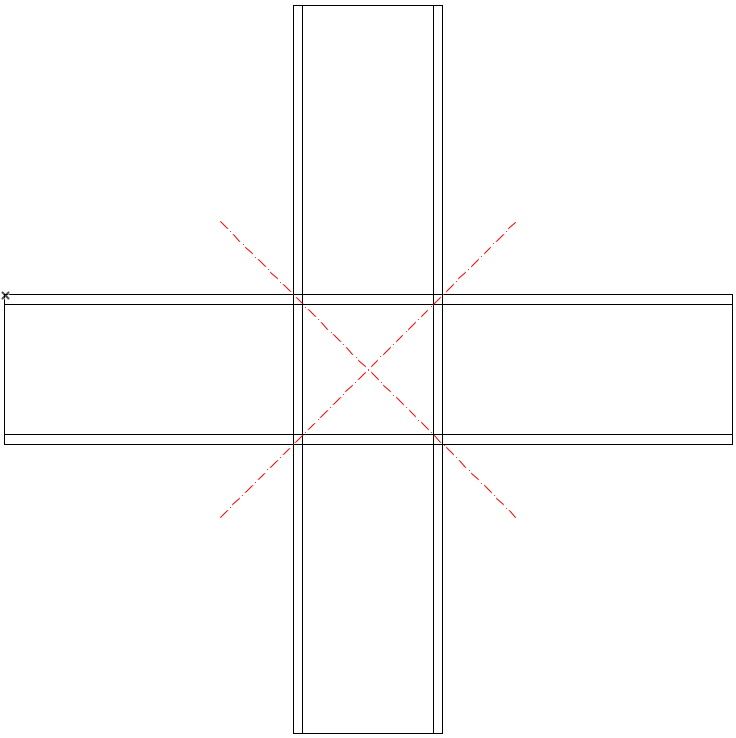

Have two barrel vaults intersecting. They are made from beam profiles, which is quick and easy. However, can't seem to get the SEO intersection quite right. Have attached a snapshot of the closest I can come; done with a substraction with downwards extrusion. Have tried every other operation, nothing seems to mitre the common angles as one would expect. The vaults are four inches thick, they have trim attached at the bottom as part of the profile.
Any comments?

Tom Krowka
The method from the GDL book works great. Thanks to all.
However, it still seems to me that if the profile is a beam, it should clean up automatically at intersections.

Regarding your product and cutting tool in reference to the intersection of the two vaults: I think that would be the hardest part of the process. How would I be able to tell, in 3d, with a split tool, where the two vaults would intersect. It seems it would difficult to trace that line.
No problem - you can cut the intersection in the plan view. In this case, because the cross-vaults are the same size, it is simply 45 degree cuts across the profile.
