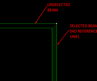

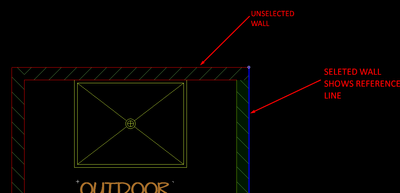

I've noticed that in Archicad 24 beam reference lines do not show upon element selection like wall reference lines do. I have to show the beam axis lines for it to show. In previous versions it used to show upon selection regardless of whether Axis Lines were shown or not.
Also with View>Onscreen View Options> Wall & Beam Reference Lines toggled on. Archicad 24 does not show
axis line and direction.
Is this intended?

Hello!
Let me try to help you. Check first the model view of the beams themselves (Document -> Model View -> Model View Options). There look at your beam parameter, it should be "Contour and Axis".
