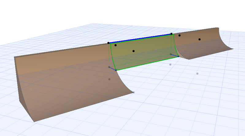

I want to connect two beams of different heights, both were made with custom profile.
On the top of the picture i show how i want to connect them, on the bottom of the picture is how they look in profile.
What is the best approach in connecting them?
Thanks!
2 Solutions
 I tried to model it by a segmented beam but couldn't as complex profile is not supported in tapered mode.

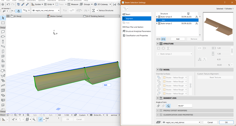

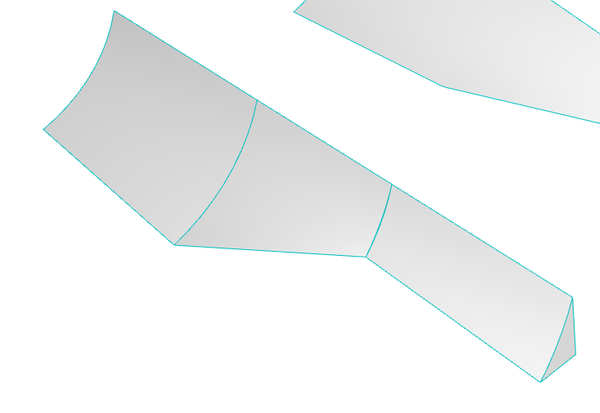

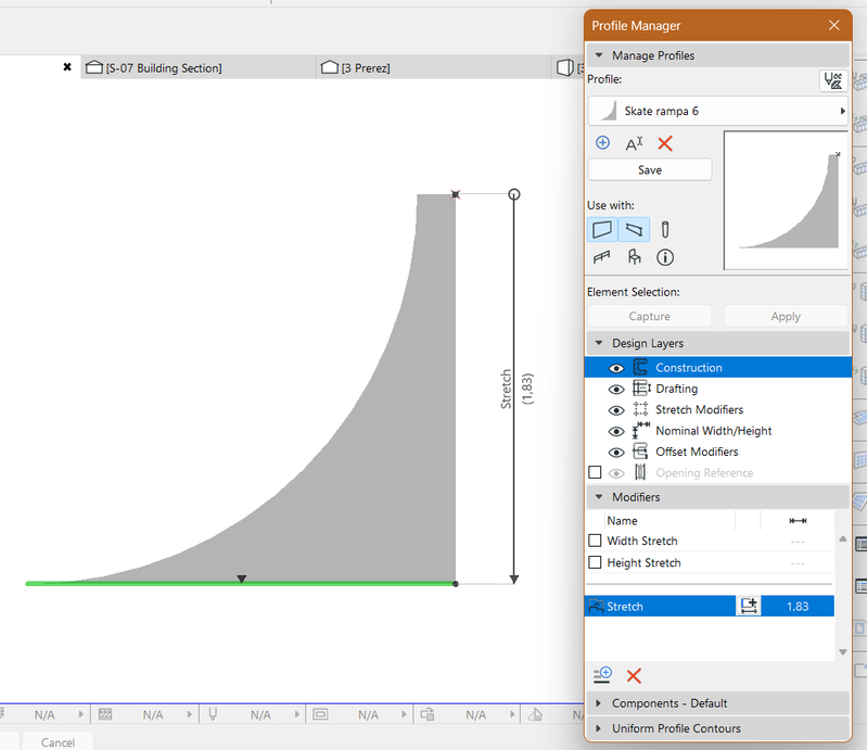

 So, it can be modeled as 3 different beams, each one has its own profile and with the help of Offset Modifiers in the middle one as follow, hope that helps.

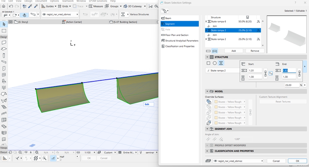

So sorry, forgot to tell you to change the beam size from uniform to tapered, you'll find start & end offsets.

Yes, thank you, this is what i want to make, specifically this one:

Charlie64
Great, it works now! Thank you!
