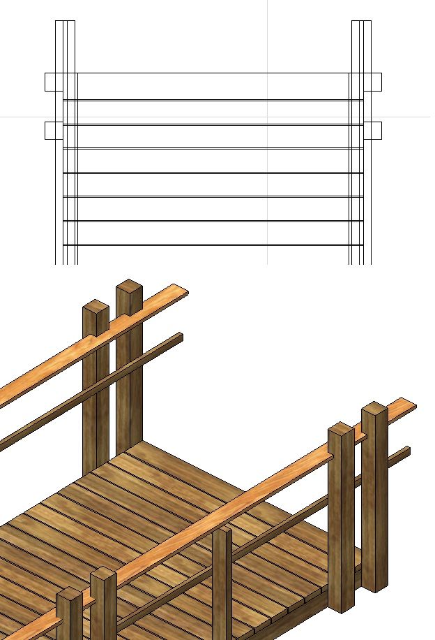

Hey,
I`m ashamed to admit that I can`t find solution to a simple problem. I have drawn a few objects with beam tool. Although some beams are lower than others and their contour lines should be hidden on floor plan, they aren`t. I`ve played with every option I can think of and can`t get it done.
Any suggestions?
Thank you

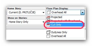

Dont panic: one solution
David Maudlin
Rockstar
Raiko:
Beams do not have cover fills, there is a thread and poll here:
Cover & Background Fills for Beams
David
