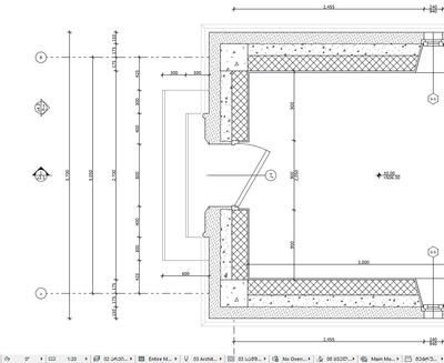

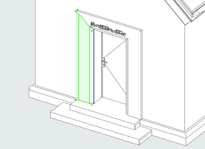

Hi there. I had some issue with Complex Profile Column and Wall Composite connection. I am doing this small gate casing outside the wall face. If the column profile has a sloped ending, the connection between the column and the wall on the floor plan is separated with the contour line. See photo:

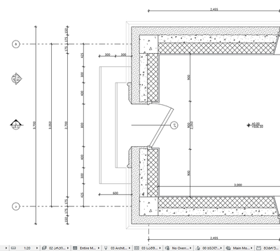

But If the column has a horizontal ending, the connection between the column and the wall on the floor plan becomes seamless. See photo:
I want this seamless connection between the column and the wall but also want to keep the sloped ending of the column to finalize the outside casing.

Interesting problem.
The only fix I can see is to edit the edge of the complex profile and turn off that cut line.
That means that line will always be invisible when you use that profile.

Woah that looks like the best solution! Thank you!
