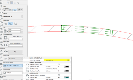

Check that you don't have selected 'Overhead all' in 'floor plan display'.

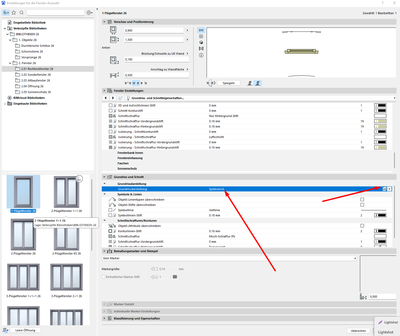

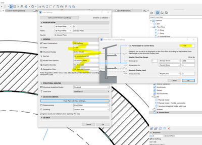

Check in the 'Settings dialogue -> Plan and section' that you don't have fills set up with a transparent background. Excuse my Swedish settings.
Isaac Newton
Thanks! No problem, mine is German) But it doesn't seem to work. As to the Floor Plan Display, it says: "Symbolic", and the hatch pattern still shows through:

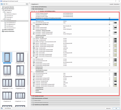

And as to the settings for plan and section, I haven't found all that you have shown in your screenshot perhaps:

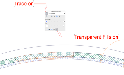

 Maybe just Trace on with Transparent Fills on ?
ArchiCad 3.43 to 28
MacOS Monterey
That's it! Thank you very much! The wall is existing, but the window however is just new. No parts of that wall are set for demolition. Except the brickwork inside of the given window. But, perhaps there is something that can be done about it, except tracing it with the mask fill?
