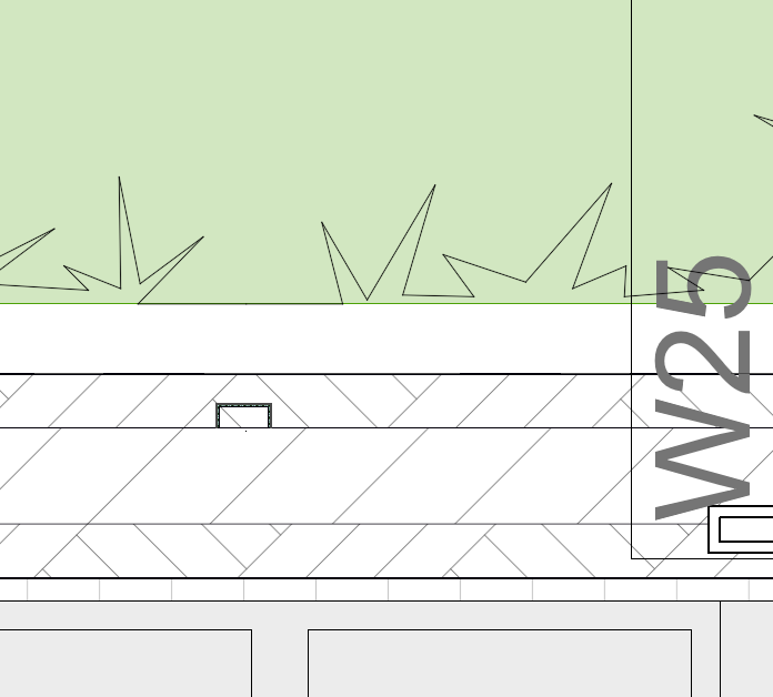

Hi there,
Why is this column not showing on top of wall?b I've tried to change display order and make the building material of the center of the wall transparent but it still isn't working...

Building Material Intersection Priority? My assumption is that the middle of your wall has a greater value for this parameter, so it will be cutting your column. Your options are to either make it so that your column uses a Building Material with a higher priority than that of your wall, or to have your column on a seperate layer that has a different Intersection Group than that of the wall so that they do not participate in Priority Based Intersections with each other.
Ling.
