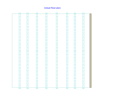

I have such situation on the floor plan: 1.Floor(slab) - 2.cut plane above 1.Floor - 3.tilted beam above 2.cut plane - 4.ceiling(slab) above part of 3.tilted beam - and another part of 3.tilted beam above 4.ceiling. There is an overhead line of  full beam on the floor plan, but should be only part(under ceiling). What should I do to hide part of the beam above 4.ceiling(slab)?

I've posted few pictures, hope it will help to understand the problem. Pic.1 - section, Pic.2 - floor plan, Pic.3 - floor plan that should be.
Try these settings for the Beam as shown in the screenshot:
1. "Floor Plan Display" field to "Projected with Overhead".
2. "Projection Mode" to "Hybrid", and "Overhead" to "Projected".
3. "Show Projection" to "To Floor Plan Range".
