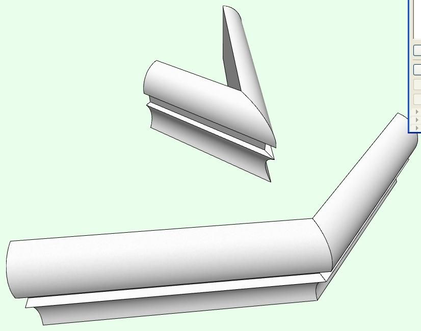

They should clean up. Can you post a screenshot?
Are the beams horizontal or is one or both sloped?

I've made a screendump that shows the problem. The beams are put on top of wall-panels (?) that cover the lower part of the wall, as in classical interiors.
In 2d view I've aligned the beams so they fit together.

Anne wrote:select those 2 beams and use intersect command. They must connect right !
Hi Erika

Thank you very much, Erika. That solved the problem. I had no knowledge of this command, but now I've learned.
