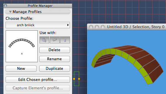

You won't get precise texture mapping on shells, morphs or any distorted surfaces since Archicad is poor with UV challenges.
I suggest that you actually model your brickwork on the arch sides and use texture mapping only on walls above. Achieve this by making a complex profile fill of the individual tapered blocks arranged in the complex profile editing window. Use this fill to define a beam drawn across rather than along the span.

Thanks for your help Dwight, that worked well! Do you have any suggestions on how I could possibly map a texture on the face of the arch? Would I better off using something like Artlantis?
