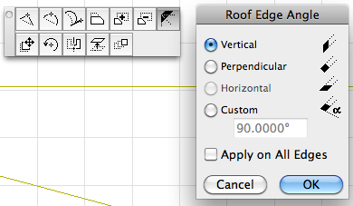

As suggested in your other thread, select one roof, CMD-Click on the edge of the other and it will extend / trim to where the two roof planes meet. Then select 2nd roof, CMD-Click on edge of 1st roof, and it too will extend or trim to the appropriate position.
Also make sure your exposed roof edges are vertical using the pet palette as shown below (AC11 shown, might have changed slightly in later versions)
I find sometimes my edges go off vertical, especially if I have been modifying the roof alot. To fix I just grab the properties of the roof with eyedropper tool and re-inject it back onto the same piece of roof to fix.
