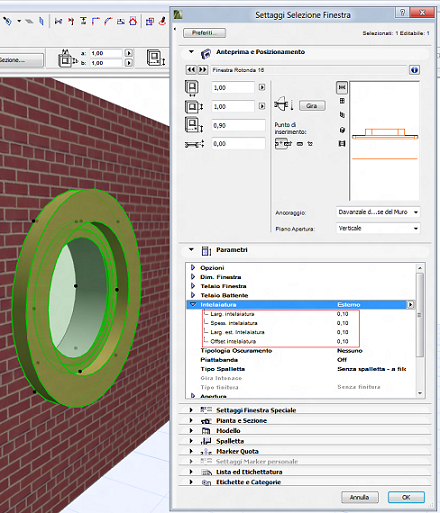

Dear Nicola,
We checked the Window Settings again, and it worked well from the Parameters list. I attached an image about this setting.
If it still does not work on your computer, please forward the .pla project to us.
I am waiting for your response.
