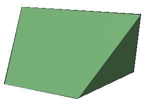

Can I create this shape of wall??
I made this model in 3DS, I hope you'll understand what I want to
I know how to make a slanted wall but I need shorter top than bottom

Like this?
The last thing you do after you have build your wall and the too roof is :
Open 3d view
Select wall
Rightclick
Use Trim to roof
(If you use SEO instead of Trim to roof, you have to put your cuttingroof in a layer that you hide. If you use Trim to roof you could erase this roof if you don't need it anymore.)

loool..thats funny .. such an easy thing that u might even don't think how to do it , and you just do it ,... and it took us 2 pages to discuss that !!

Yes, that's right way - I made it
Thank you all guys
