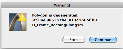

Hello,
I am having this error message each time I open my current file, and each time I open the 3D window in this specific file. I've tried to do a SEARCH & SELECT but it doesn't find the corrupted object. Any idea how to solve this problem? I have to press enter like 20 times each time I go to the 3D window and I do that a lot... Tks.
2 REPLIES 2
This is a MACRO object for the Door Frame. You have input a non-correct value in one or more of the door frame parameters. Check it carefuly:
1. Set the walls in 3D view to Wireframe mode and find the door with a degenerated frame.
2. When you find that door, correct thzat parameters.
