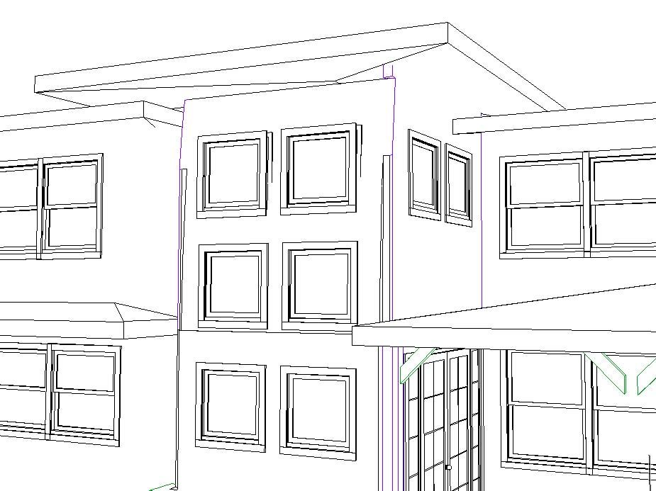

I am creating bowed or arched wall based on a complex profile that I've created.
I'm having two problems with the bowed wall. The windows placed in the wall do not match the arch of the wall (see image below). The other problem is where the arched wall intersects another wall.
Please let me know if there are ways to get the windows to lay flat in an arched wall like this and if there is a way for complex profile walls like this to intersect cleanly with straight walls.

here is another view of the problem wall intersections and windows in the arched wall created with a complex profile

Aloha Adrian,
Adjusting the opening reference lines worked to tilt the windows in line with the wall it did not entirely fix the situation as the window trim does not show up on the outside of the wall.

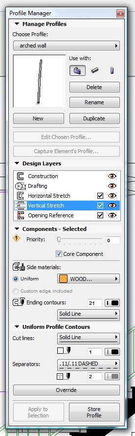

here are the settings for the complex profile
profile editor
