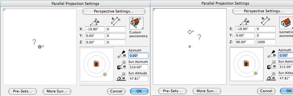

Further progress...
Pretty sure before when I selected the Selection Arrow tool, and "Select All" ( Apple-A), nothing was selected. Now things appear to be selected (189 items total, 144 walls, 3 slabs, 8 roofs etc) but zoom to selection or zoom extents have no effect. The Edit selections button is greyed out too . And looking again at the 3D projections settings dialogue, there is no "house" to indicate the model in axo views (see image). This is suggesting to me that there may be something far away (or at a very high or very low elevation) but i can't find it. And why this strange phenomena would happen even if only a single item is selected to show in 3D window, I don't know.
Curiouser and curiouser.
