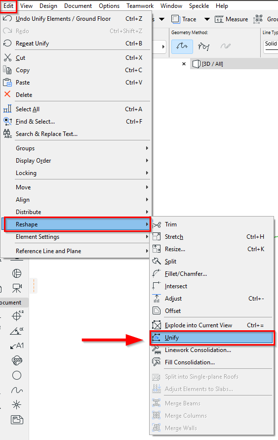

Is their a way to continue an existing spline (add points after the last point)? I don't want to drag the endpoint or add points on the spline. I want to add points after the last point. Similar to how you can continue a polyline (See attached).

You cannot continue an existing spline as you can continue a polyline but you can create as many splines together as you need and Edit> Reshape> Unify
See the image and video attached.
