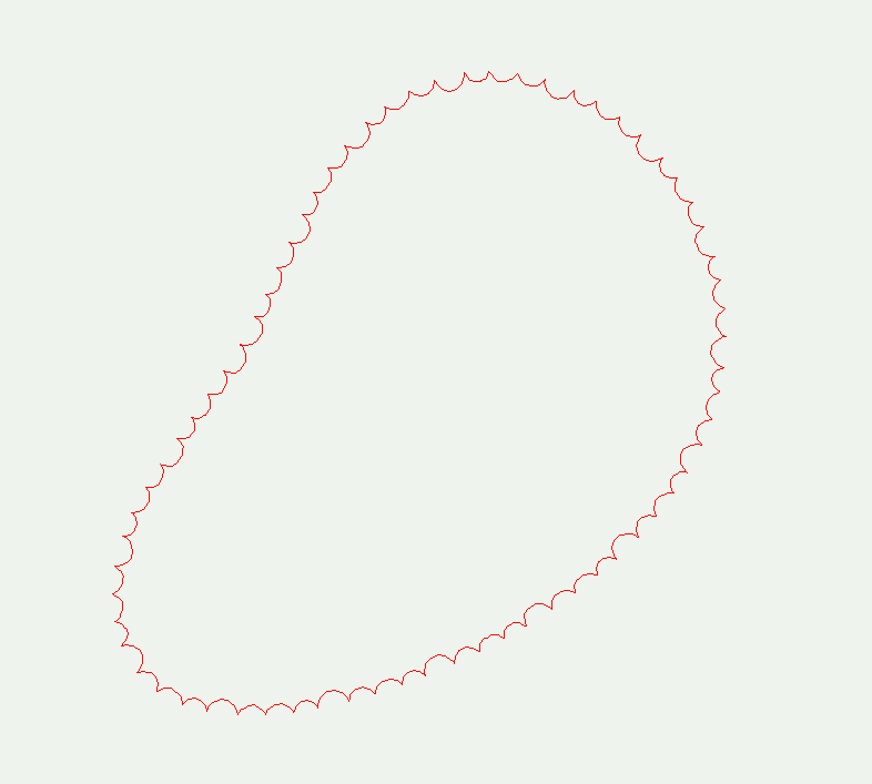

I get this almost every time I draw a Revision "cloud" using a closed spline.
I feel your pain, brother! I've had to start using the open spline and make it close myself. It would be nice to reverse a line direction the way you can with a wall!

If I draw using the closed spline in a clockwise direction the cloud is always pointing in the outwards direction. If in a counterclockwise direction it will invert. Does this not work for you?
