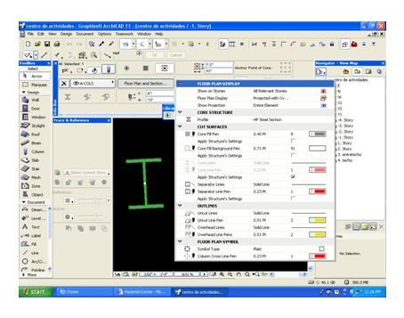

They're talking about the Structure of the Complex Profile of the Column. If Apply Structure's Settings is ticked, then the settings under Cut Surfaces will not override the settings of the Complex Profile.
To edit the 'structure's settings', you need to go to Design> Complex Profiles> Profile Manager... Then select the Profile that's applied to your column and change the Cut Line Pen. Then hit Override and Store Profile.

Im still having problems changing the color of columns.....
This column is a simple 12" x 12", not a profile. Doesn't have a veneer.
The program doesn't allow me to change the color of core lines (It is greyed)
Cut plane is 4'-0" AFF.
I dont know what else to do.
