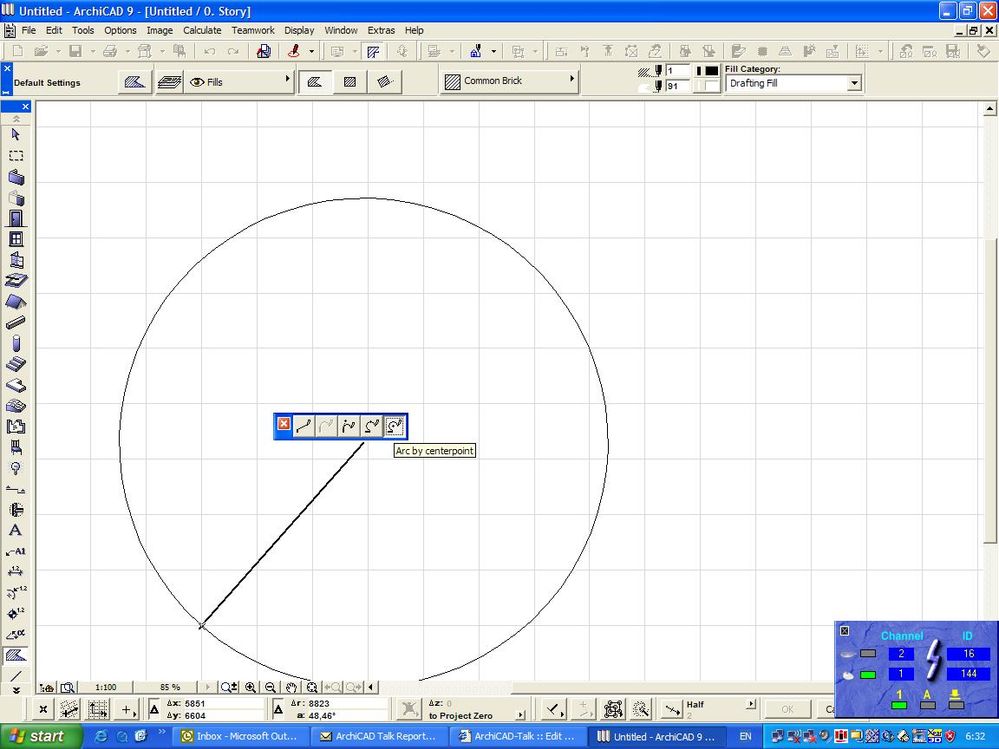

Circle Fill
Would like a circle option under the Fill command.
Thanks.

This may or may not help. After drawing your circle push the space bar on the keyboard with the fill tool active. The magic wand appears and then mouse click in the circle. The fill then fills the whole circle.
For curves on the pet palette there is a curved option.
Cheers,
Djordje
Moderator Emeritus
It is there. When you start the polygon fill, in the Pet palette one of the options is circle with center defined. Click on it, the first point of the fill that you clicked is the quadrant. Now click for center, again on the first point, done.
The same goes for circular slabs.
No need for the old magic wand trick any more.
Djordje
ArchiCAD since 4.55 ... 1995
HP Omen
Works Great! Thanks.
Djordje
Moderator Emeritus
Don't forget - the same can be used for any polygon. And polyline.
Djordje
